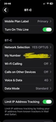

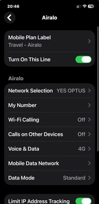

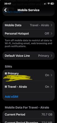

Hi Alex
Thanks for your continued support.
beeps x3 happens with UK and AUS numbers
tried rebooting and also doing a ‘hard’ reset on iPhone - volume up down and keep finger on off button until Apple symbol. Also turning airplane mode on and off.
when I do make a change of carrier I always get a SMS saying new voicemail so something is happening on the carrier side
i I have attached a few screenshots
