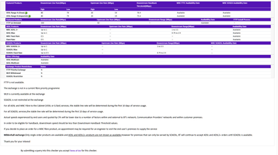

enter your address and post the results  remember to delete address

Re: Engineer been twice without warning and not installed Broadband
3,081 Views
Message 4 of 8
as you can see from the dslchecker results FTTC 80/20mb is available to you and cabinet is not full
you should be able to order fibre package
