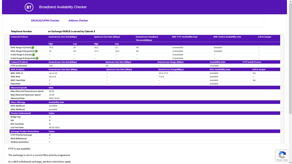

No point getting an engineer out if they are designed to be the same as claimed by the chat agent. FYI here is my Broadband Availability Checker result ...

Potentially better speeds are available according to the DSL checker , but without reference to the router statistics you will never know for sure

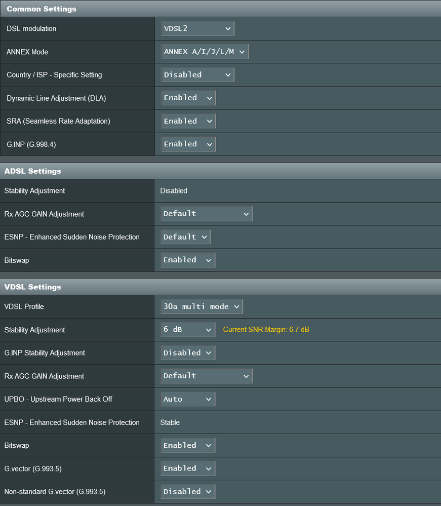

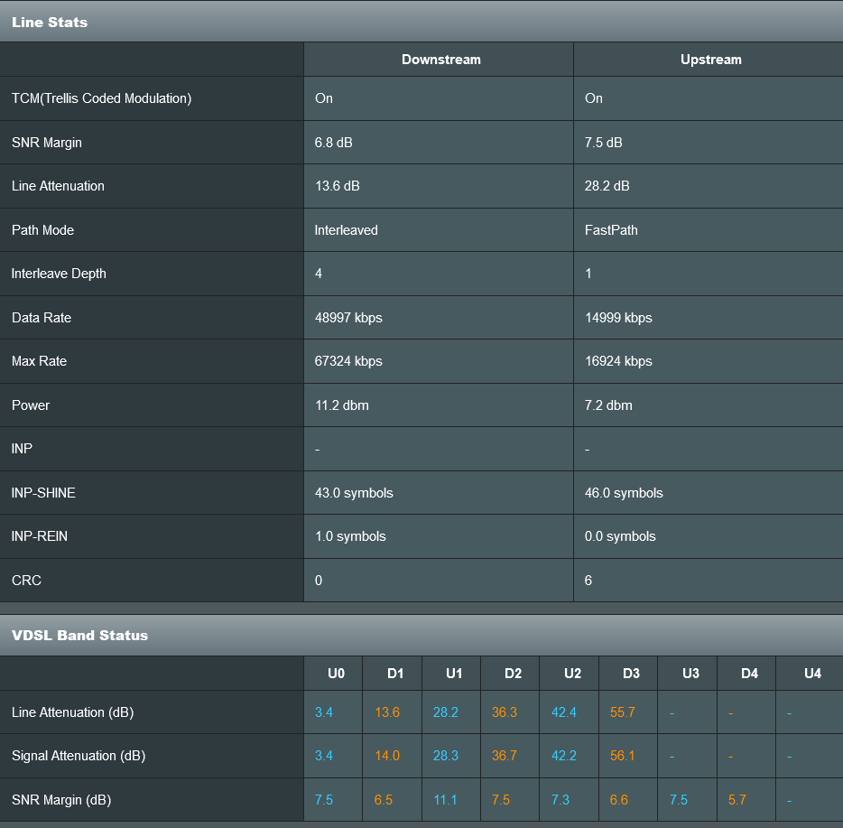

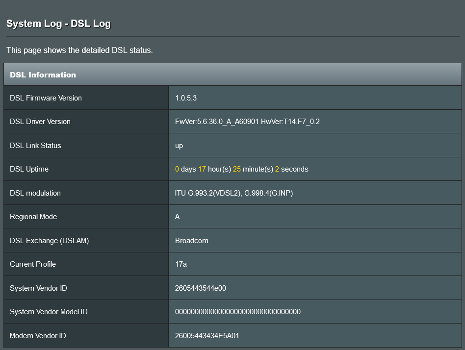

@imjolly  here are screenshots of the logs and settings on the ASUS DSL-AC68U router. Although not the BT HH6, they should provide equivalent information.
DSL InformationDSL Information
DSL Line StatsDSL Line Stats
DSL SettingsDSL Settings
At the time of the screen grabs, you will see that my DSL line has been up for over 17 hours since last line Down/Up occurred at approx 8pm last night.
