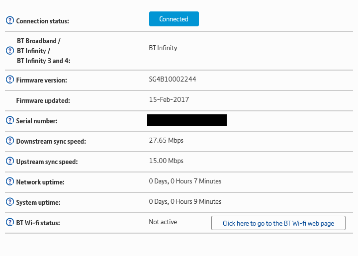

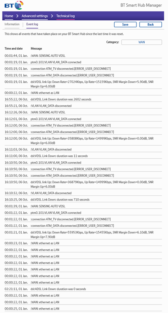

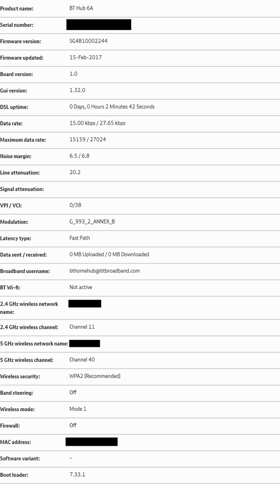

UPDATE
Reverted to my BT HH6 yesterday afternoon.
Initially it reported;
VDSL link Up: Down Rate=55953Kbps, Up Rate=15455Kbps, SNR Margin Down=6.10dB, SNR Margin Up=7.90dB
I ran the 'Broadband performance test' which reported a problem so I then ran the troubleshooting and this eventually opened a web page saying there was a fault on my broadband line 'outside the home' and an engineer visit has been booked for Wed 11th October.
I checked the hub stats after the tests and got the following;
VDSL link Up: Down Rate=35808Kbps, Up Rate=14999Kbps, SNR Margin Down=0.00dB, SNR Margin Up=6.00dB
I didn't like the drop in speed or the zero download SNR margin, so I clicked 'Restart the Smart Hub' and after the restart the stats were as follows;
VDSL link Up: Down Rate=27024Kbps, Up Rate=15159Kbps, SNR Margin Down=5.90dB, SNR Margin Up=6.00dB
Going from bad to worse.
At the moment, approx 22 hours later, the technical log is now showing;
Data rate:  15.00 kbps / 27.65 kbps
Maximum data rate:  15159 / 27024
Noise margin:  6.7 / 16
I have included below screen shots from yesterday afternoon showing the Status, Technical Log and Event Log (WAN) after the test and restart. I will leave things as they now are and keep the hub switched on and post a further update after the engineer visit or sooner if there are any dramatic changes.
HH6 StatusHH6 Status
HH6 Technical LogHH6 Technical Log
HH6 Event Log (WAN)HH6 Event Log (WAN)
