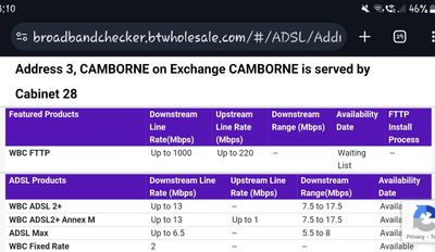

You have cut and pasted the text from the checker and it’s presented in a not very ‘readable’ way , could you basically capture an image/photo  of the entire checker return, including the survey notes and attach that image here ? It will make it a lot easier to see what is and isn’t available.

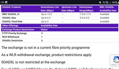

The exchange is not in a current fibre priority programme
As a WLR withdrawal exchange, product restrictions apply
SOADSL is not restricted at the exchange
For all ADSL and WBC Fibre to the Cabinet (VDSL or G.fast) services, the stable line rate will be determined during the first 10 days of service usage.
For all SOADSL services,the stable line rate will be determined during the first 10 days of service usage.
Actual speeds experienced by end users and quoted by CPs will be lower due to a number of factors within and external to BT's network, Communication Providers' networks and within customer premises.
In order to be eligible for handback, downstream speed should be less than Downstream Handback Threshold values.

I hope this is better. I've just come off the phone from BT who said they had spoken to OR. Apparently its not an option to revert back as the copper has been withdrawn from this area and that I will get a call before 24th June...that's all the info I have.

I did not see any mention of copper withdrawal, but if its in an FTTP priority area, then FTTP would be the only option. That does not seem to be the case, perhaps BT do not want to place an order for ADSL?
There are many people in your situation, having to wait many months for a connection.

You have cropped the image so the survey note is still note visible, it may help in determining if waiting list is the only issue or there are other factors.
As stated previously once FTTP is available ( presumably even if it’s waiting list , although AFAIK , that variation hasn’t arisen before as a query on here ) FTTP is the default network and orders have to be raised against that network, the copper network isn’t ’available’ in these cases , the only exception AFAIK, is if an existing customer orders FTTP at their current address and it turns out excess construction costs will be necessary, it’s possible for that customer to return to the legacy copper pair ,if the costs are unacceptable to the existing copper pair user, as you are a house mover this doesn’t apply to you , and it’s an ‘exception’ type order anyway, so very rarely used.
