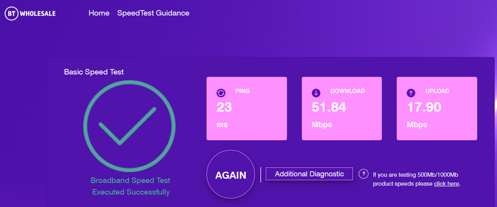

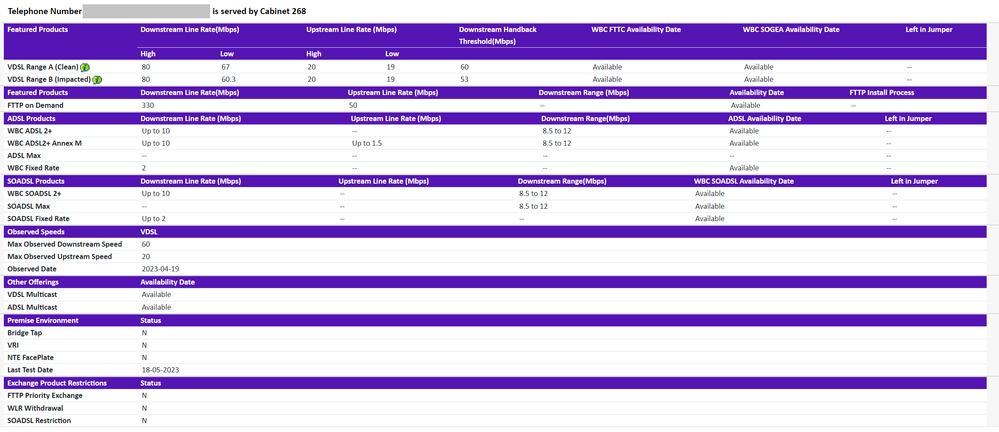

Not sure whether I need to open a new thread ... but I'm the original poster of this.
Things haven't really improved much ... and I've noticed slowness in websites loading the past week or two.
These are the latest stats (I'm still on Fibre 2):
The above speed test is what I get at any time of day, even off-peak quieter times, like now (11am).
Nothing has changed with the setup, and the phone line is very quiet with no crackling or anything.
Any pointers gratefully received!
Many thanks again.

as requested previously you need to post the stats from your SH2 - there is no SH3 - by going to hub manager then advanced settings then technical log information (not the actual logs)  this will help people help you
Have you tried the quiet line test? - dial 17070 option 2 - should hear nothing - best done with a corded phone. if cordless phone you may hear a 'dull hum' which is normal
Someone may then be able to offer help/assistance/suggestions to your problem

your stats look like vdsl - fibre to street cab and copper form there to your home not FTTP - fibre to your home
are you for some reason using a modem and the HH3?
if just HH3 like expected then
From http://192.168.1.254
Settings ->
Advanced Settings >
Broadband >
Connection >
Click "Show Details" Button at the bottom

the original dslchecker results showed down speed at 55mb whereas the recent results showed speed not at 60mb
it may be time to ditch the old openreach modem BT hh3 and get more up to date HH6 or maybe SH2 ( hh6 better for your vdsl)
