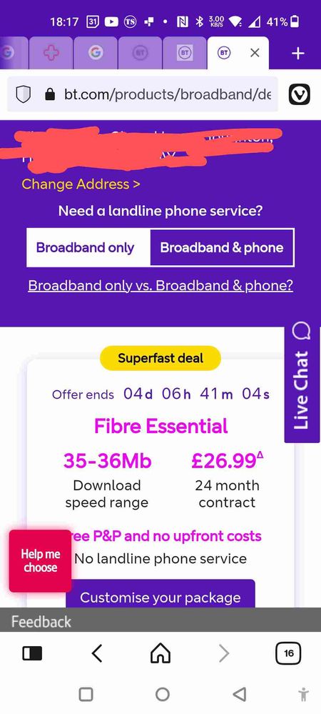

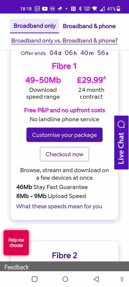

Please post a screenshot of the checker result after editing out personal details.
3,080 Views
Message 8 of 8
Re: Renegotiate package with BT
Screenshot_2023-03-26-18-17-56-22_d365b52accad0f47adbc08c16219827d~2.jpgScreenshot_2023-03-26-18-18-04-26_d365b52accad0f47adbc08c16219827d.jpgScreenshot_2023-03-26-18-18-13-18_d365b52accad0f47adbc08c16219827d.jpg
