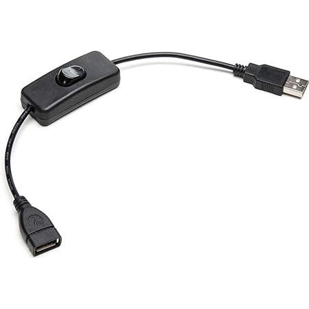

@NickBS
If manual control is acceptable, then you could use a switch in the power cable.
I use something similar to this to control power a Bluetooth audio receiver that I don't want running continuously:
Try searching on a shopping site for "USB Switch Cable" or similar.
