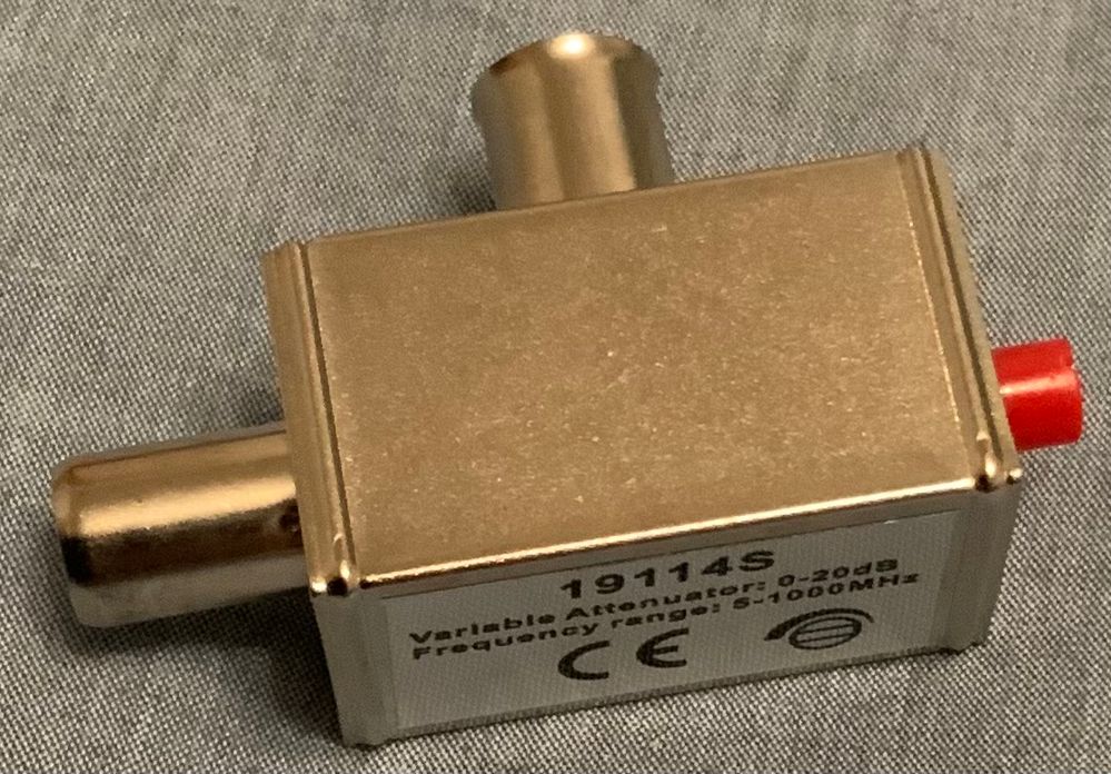

@Terrior
Get a variable attenuator; you turn the little red control (thank you, obscenity filter) for anything from 0-20 dBs of attenuation. A few quid on Amazon, and no doubt many other places. There’s no wrong answer with a variable one; you just tweak it until it’s right.
This one looks gold here, but it’s actually silver; looks like the white balance in the photo is off, but you get the idea, hopefully.
Pull the aerial off the back of the Pro box, plug it into the attenuator, then plug the other connector on the attenuator into the box.
Go to Settings/TV Signal Quality and twiddle the red control until the Signal Strength is about 80%. (Actually you can keep going until the Signal Quality drops below 100%, and then just dial it back a fraction to be 100% again, but only go that far if you are getting pixelation still at 80% Strength).
Check on the TV that the signal is still strong enough there also.
Hopefully the pixelation will cease; though I have to say I’m getting it at the moment with this severe weather we are having, so you might have to tweak the red (unsayable) again when it’s over.

I am getting so frustrated with this too! Constant error message and signal message constantly. I do not understand the attenuator? Is it simple to buy and install?
5,446 Views
Message 18 of 19
Re: Pixelation
@jeanjeanie2 You can get them on websites like Amazon or eBay, they're cheap, and you plug it into the aerial in slot on the back of the BT box and plug the aerial cable into that.
If you've bought a variable one, you might want to check the signal strength in settings as you adjust it. You want 100% signal quality and 80-90% signal strength. All your problems will then go away.
