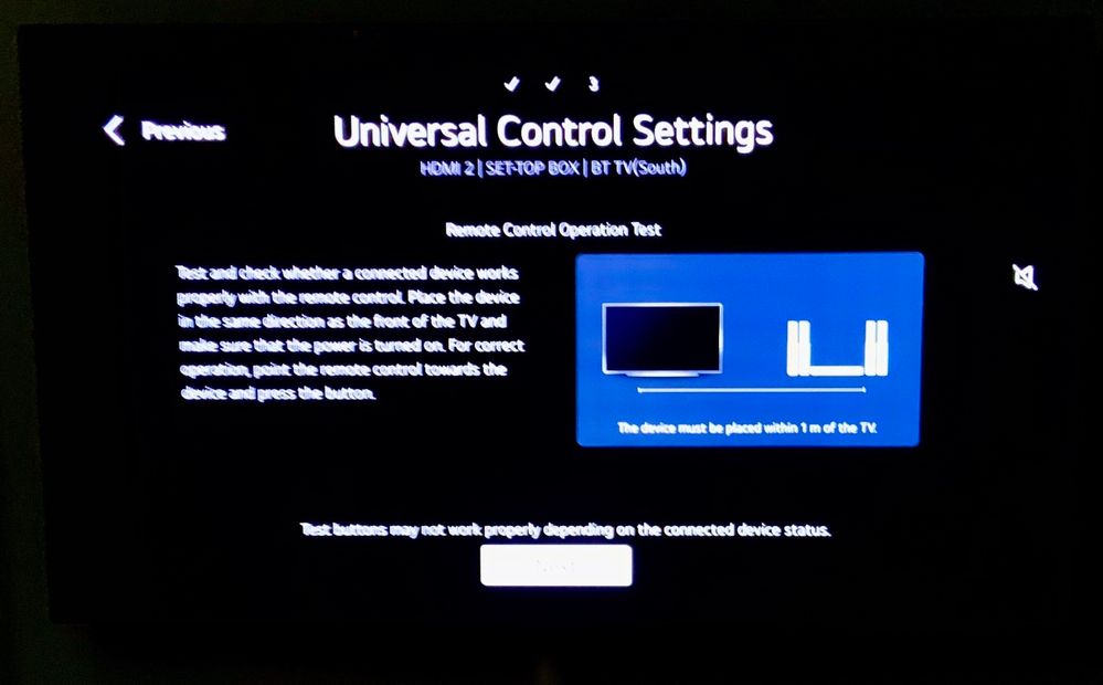

I'm aware you have a G3, with a newer remote than my GX, so I wondered if this explained anything. So I looked at our bedroom C2, which has the new remote, and the Universal Control a little more automated than the GX. But you can insist on setting up Universal Control manually, so I tried this on the C2 with our upstairs YouView box, a DTR-T2110, and during the setup I got this screen (which I can also get on the GX, but I think it’s more indicative on this later TV):-
You will notice that it says to point the remote at the device. Significantly, not at the TV.
Which I can bear out for my BluRay player, some way below the TV and in a glass-fronted cabinet, set back so so popping the tray out doesn’t hit the glass, which require pretty precise aiming of its own remote, let alone the LG one.

 i have been thru that screen trying different device types, i think it’s probably the wording when it states “point at the device” & most likely means the TV, i’ll show you why.
when you click on the “next” button you will end up on the screen i have attached, it requires you to point the magic remote at the TV & specifically point the cursor over the PR button to check the STB channel changes when you push the LG OK wheel, so basically it’s impossible to point the remote at a different device to the TV.
hope that makes sense.

Mine jumps through that screen without stopping - I had to take a video and look at the exact frame to see it, I expect that’s why they talk about 1 metre and facing the same way.
