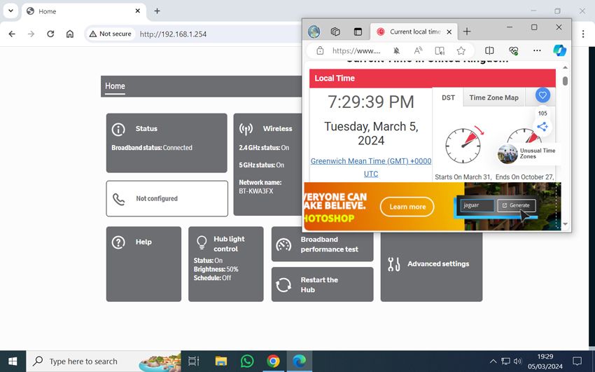

Indeed - I don’t know how many different ways of trying to say that his DV service has not been provisioned could have been tried!
The steps are:
1) Complain to BT to get the Digital Voice service provisioned as that their phone number appears next to the telephone symbol in the box on the left hand side of his smart hub home page.
2) When that happens they will then be able to click through to another page on the routers web page that will let them pair their DECT handset with the Smart Hub 2. No cables required!
Until Step 1 is achieved Step 2 cannot happen.

5 march not working.jpgUPDATE
Still cannot make or receive calls.
Technical help have told me that my telephone muber has not even been "ported" yet - whatever that means - but my BT Executive Connsumer Complaints Resolver, is still blaming me, saying everything their end is in working order and it is my fault that I have not set up my handset properly!
