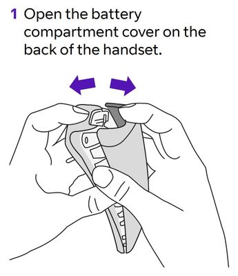

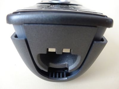

Hi @redls   I suspect you need new batteries, as you say you have had it for some years.

Hope that will work, but my hands are not strong enough to open the cover, will have to get my husband to do it.

Thank you everyone.  Husband had a struggle but managed to open the back. Changing the batteries seems to have worked... Hope it lasts! We have a reserve of rechargeable batteries, but might be an idea to top them up. I tend to forget rechargeable batteries doesn't mean they won't stop recharging effectively!
