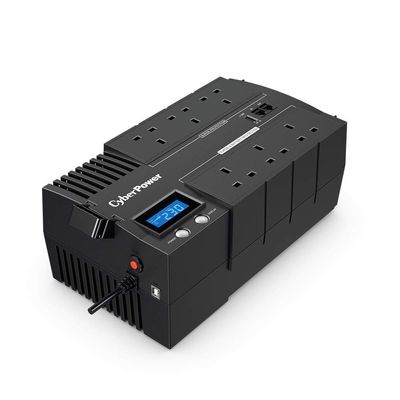

Something like this will cover all your needs:
When I say 'all' I mean most eventualities.
I do think truly rural areas (a few in Scotland had no power for 8 days a few weeks back which is unacceptable) need to have some sort of backup for themselves (ie a generator) but also something supplied by councils/government maybe in a local shop like a satellite mobile telephone.
I have a backup myself for my FTTP and if I lived in a rural place I'd also have a generator or two.
I wouldn't bother my MP it's up to all of us to do as much as possible for ourselves and if people really can't cope then century old technology (which needs electricty somewhere and intact cabling) copper line isn't going to provide for any miracles.
People need to be prepared and those who won't will just have to suck it up and those we can't will need statutory intervention by local authorities at some stage. Nothing new there.
