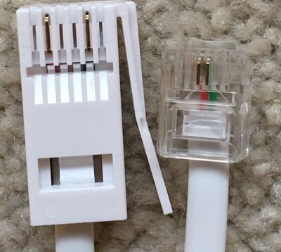

The actual issue is the internal wiring of the phone & this harks back to early modem days. Although the RJ11 connector was adopted as standard, the way it was wired wasn't. So some devices used the centre pair & others used the outer pair. So all you can do is look very closely at the colours used at both ends, which will probably require a magnifying glass unless you have excellent eyesight!
It's all a long time ago for me but I think the BT plug uses pins 2 & 5, ie one in from either end. They will either go to the middle pair of the RJ11 connector or the outer pair. Whichever you have you need to find the opposite, maybe try the cable from your router unless you have FTTP?

Just checked the cable on my BT8500 base & that has pins 2 & 5 of the BT plug connected to the centre pair of the RJ11 like this:
You would hope that it's standard across BT products.
