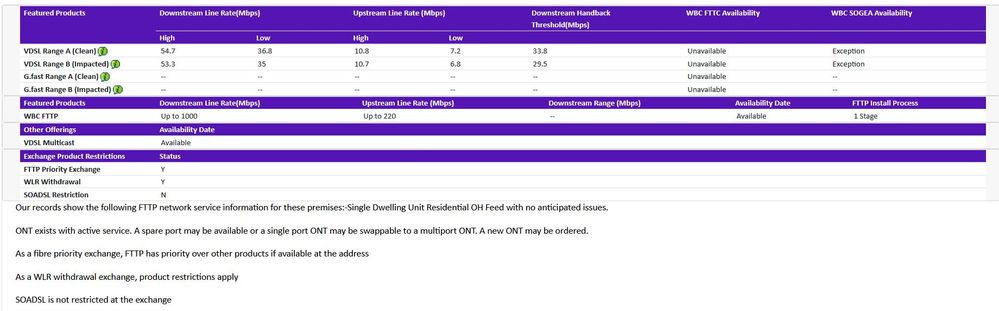

Here are the results from the checker recommended by @jac_95. It confirms that I'm in a FTTP Priority Exchange and the service can be delivered by overhead wire. The tree mentioned has been lopped recently and shouldn't be a problem.
Existing propertyExisting property

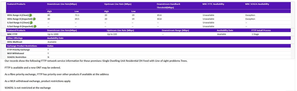

With my increasing knowledge (and confidence!), I also checked the new address which has a very similar profile. It confirms that an ONT is already installed, which is as I thought. The vendors haven't mentioned this but it's used by the son and they don't seem to know what they're paying for.
New PropertyNew Property
