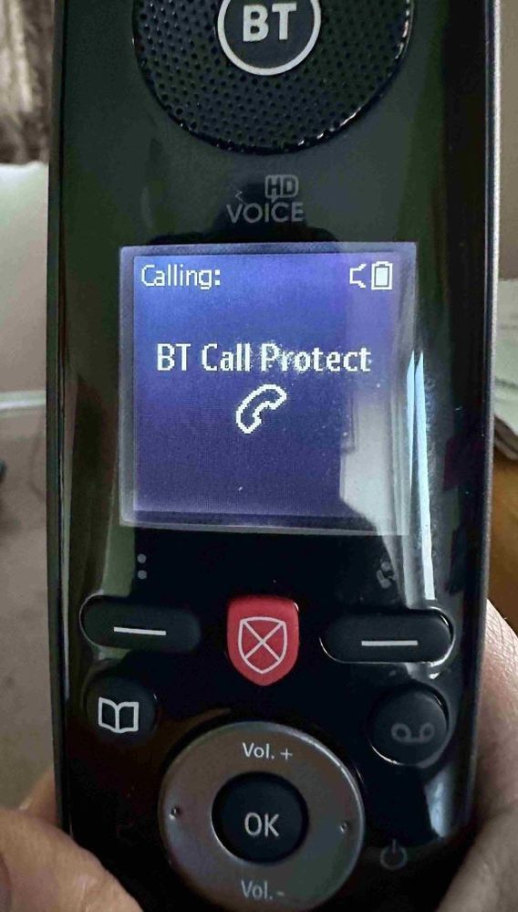

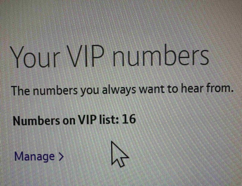

So I'm here today. I've tried pressing the shield on the handset and it calls "call protect".
I can't see anyway to find any blocked numbers? and there are any on the website. Yet neither myself nor my husband can get through on our mobiles. We are on different provides by the way.
The BT guy I spoke to on Christmas Eve could get through. I'm at a loss.
Any suggestions?
