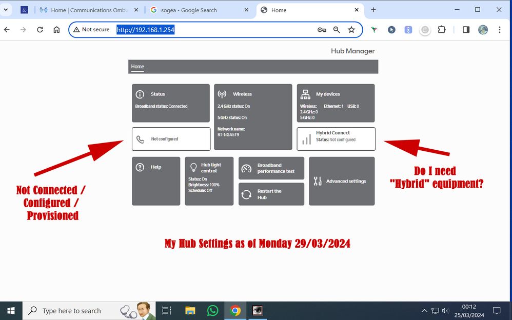

@Customer66 Digital Voice works fine with Full Fibre (FTTP). No copper connection is required.
The digital voice service is delivered through the BT Smart Hub 2 as that acts as the VoIP/SIP gateway to BT's specific Digital Voice service.
What issue are you having?
Edit: reading your posts it sounds like your having issues getting the digital voice service to connect?
What does the status show for the phone when going into the BT Smart Hub 2's managed UI?
http://192.168.1.254
Should look something like this (bit highlighted on red)
5,968 Views
Message 4 of 21
Re: Does Digital Voice Actually Work With FTTP?
5,936 Views
Message 5 of 21
@Customer66 - thanks for posting that information.
Ok so from the phone dialogue on the left suggests that your hub hasn't had been pushed and applied the appropriate configuration settings successfully so it's not fully set up yet. This is done remotely
The hybrid connect one on the right isn't needed for Digital Voice, it's a separate add on that uses the mobile network as a fallback to allow you to continue using the internet when the main broadband connection is down.

in your first post you mentioned you had moved home and all the phone problems stated after that move    when you moved did you actually move from one phone exchange are to a different exchange as that would stop you retaining your existing number?
as has been posted many times until you see phone configured and a phone number in hub manager then you will not have an active home phone
