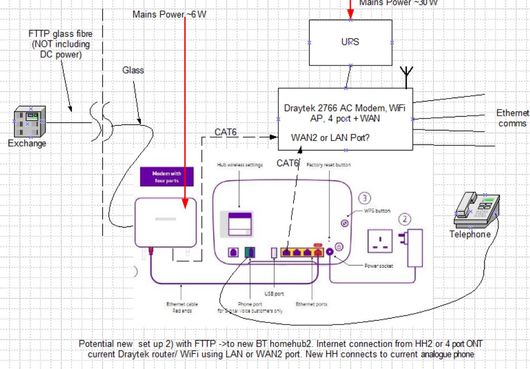

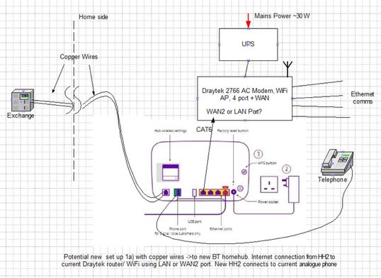

3. I did take the time to go to the local "experts " forum where I carefully explained with diagrams my set up. I could have expected to get the facts here and was **not** told anything about proprietary.  The expert agreed that if my Draytek had VOIP and phone sockets (it does) then that could be a way to get DV over copper or glass.

So I revised my diagrams to reflect my new learnings and using the diag from the start of this messaging chain.. This indicated a 4 port ONT box.. Could I get one FoC?
New queries. Help please to answer these and settle the technical issues.
>Diag 1 - copper wires / VDSL -> HH2= DV+internet
If I keep copper wires /VDSL and use the HH2 for my phone, I can connect the HH2 to my Draytek - but
1) do I use the LAN or WAN2 port on the Draytek?
2) I am not sure how the IP addressing would work with my Draytek - would the HH2 accept DHCP served from Draytek? or do I have to work some static / reservation scheme? Does HH2 allow a static IPaddress?
>Diag2, FTTP -> Using an ONT 4 port -> HH2
 In principle I can connect Draytek to the 4 port ONT (If I can get this of course), or to the HH2 (as before).
3) Presumably better to connect Draytek to the fibre optic modem - right?
4) again, would I connect to the Draytek Wan2, or LAN?.
5) Again will IP addressing work by DHCP from Draytek.
Thanx for reading..
