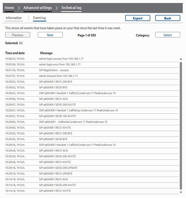

Router event log attached Last 30 minute call cut off at 1039
I wonder if there are any settings within the router which need to be changed?
