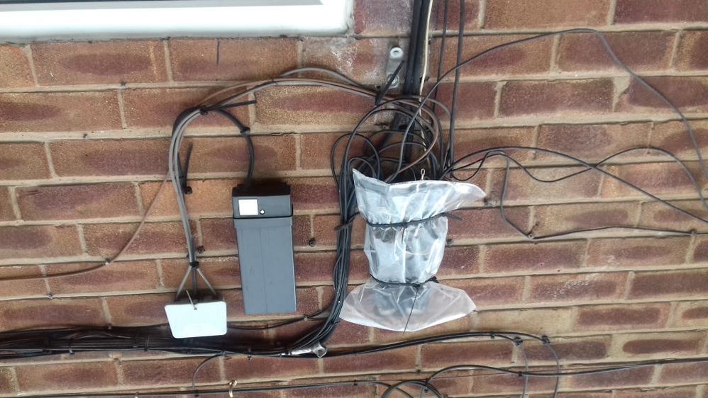

 phonewire attaches to left ''panel''phonewire attaches to left ''panel'' Hi, yes I've tried the 17070 number scores of times; it was helping a bit til my phones went dead. Also these are pics of the mess of wires on my outside wall. The phonewire is connected to the ''panel'' with the plastic sheath. No connection point visible.

Goodness - what a mess of wires.
Is this a single family dwelling or a block of flats? If the former I don't understand what all the cables and boxes are for.
If it's a block of flats, see if your neighbouring flats are having the same issues as you.
The pastic sheating looks to be a temporary job and openreach need to return to fit something more permanent
