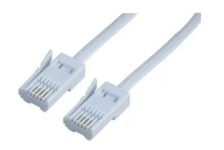

@vidjam2023
All you need to do is pop the front off the master socket & disconnect the incoming wiring from the A/B terminals. Then connect one of the sockets to the SH2 with a male to male BT431 cable:
