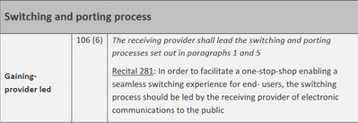

Porting comes with risks, there's never a guarantee, the porting process is an industry agreed way of working, Sky don't contact BT or any provider, a switch is 2 orders with the supplier systems, a provider raises an order to say they are taking over the line at an address, it's already working so that generates a cease with the losing provider, the order includes the port request to retain the same DN (telephone number).
ISPs are also not allowed to denegrate, it's bad practise and why nobody at Sky will confirm in writing that BT are actively blocking the port, it's incorrect and they are just pointing fingers, switching to another provider is gainer led, it's Sky's responsibility to ensure the switch, you never have to contact the losing provider, it's designed that way and has been for many years now.

BT also state the same, with porting there is no guarantee, any reputable provider will make customers aware before rasing the order, if it's a deal breaker don't go ahead with the switch, it's been an issue for years and only recently has the right to port been discussed, it's still for the gaining provider to arrange:

I hope you get the answers you're looking for, I also hope you now understand the responsibility lies with the gaining provider, BT don't block number porting, they can't do it because the market is competative and doing so would be against competition rules.
