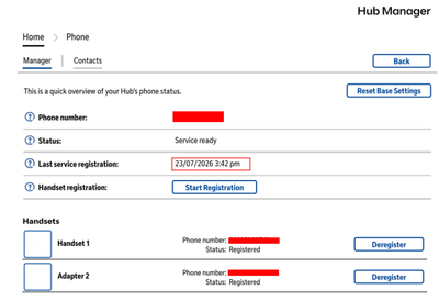

Sorry, forget DECT handsets and their base stations. The first part of my question was about whether an analogue phone attached to the hub port should appear in the list of registered handsets.
After my preceding post I remembered that last Thursday I kept an image of the Hub phone status!
As you can see, the analogue phones connected to the hub port were indeed registered as Handset 1.
So my question now is why that is no longer true and how do I fix it?
1,239 Views
Message 6 of 25
Re: Smart Hub 2 handset registration
Go to solution
Devices connected to the green socket are NOT 'registered' to the hub, registration is purely a DECT process.
All I can suggest is that you somehow registered one of your DECT handsets to the hub rather than it's base station previously. The second device is the adapter.

Whatever happened last week it had no relation to DECT registration.
All I did last week was unplug the FW500 and the DECT base station from the old analogue phone line extension socket and plug them into the hub instead.
Yesterday the Openreach engineer disconnected everything from the hub while he was working then plugged them back into the hub exactly as I left them last week.
