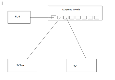

Re: BT Halo Hub - single Ethernet connection/two devices
Go to solution
Make sure you have connected similar to this with one Ethernet cable from hub to switch then an Ethernet cable to the TV and another Ethernet cable to the TV Box.  If that doesn't work you may have a faulty Ethernet cable so try swapping them around to see if there is a faulty one.

Message 8 of 8
Go to solution
Thanks - looks like one of the cables I had was not doing what I expected. Swapped it out for another and all is good. Thanks for the quick replies, much appreciated.
