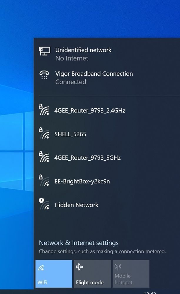

This worked. Thanks. I used my BT email address as the username and BT as the password. It left the the "Unidentified Network" (which appeared when I first plugged in the ethernet from the Vigor) as it was & created a new connection that I then called "Vigor Broadband Connection". It's using an old dial-up symbol as shown in attached image, but that's OK. The router I was using was a Linksys WRT 1900 ACS (version1) which I think came out in 2015. It seems that the radio transmitter/receiver chip may have burned out as I cannot revive any kind of 5GHz or 2.4 GHz wifi signal no matter what. Is there a current powerful Linksys model that  anyone would recommend?
