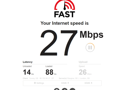

Yeh was a home  tech expert. I was expecting an openreach one. By 120mbps I mean using fast.com thats what speeds he got connecting his laptop by wifi to the router and got 50mbps by cable direct to the ONT box. Ont box gave less than the wifi speed on the router

Yeh tbh mate if i can even get 300mbps ill leave it at that. If not gonna have to take this to the regulator cuz I mean according to BT their wee app down south says im getting 900mbps to my flat so they are giving me what they promised. Doesnt matter that not even the engineers can even get 100 in the flat cuz their app says i can. Kinda feels a bit like the VW emissions scandal.
I mean if i am now paying £40-50 a month for worse speeds than talktalk was at £19.99 that cant be legal in any form

What makes me particularly uneasy is the engineer connected his phone to wifi and got 300mbps for 10 seconds then it plummeted to 100mbps. I mean ok fair enough but the hardwired computer could not break 60mbps. I mean if we just looked at wifi speed we could write it off as "everything is kinda fine but sporadic" but wifi should never be getting better speeds than a wired connection so something HAS to be wrong.

Hey man i don't mind if its been covered, just appreciate that u didnt talk down to me lol. Well this is what the issue is. THeyre measuring 900mbps down but their speed guarantee they say is just to the ONT box. If inside the flat i cant get even 40 they dont care cuz thats not what they measure. Now I have big questions over whether that is legal because only the special BT software can tell how fast the connection is to the BT box they installed that nobody has any access to. They can tell me whatever they want really. Inside  the flat, the phone sitting next to the router jumps between 40mbps and 140mbps but the direct connection to both the router and the ONT box with 3 separate computers never gets higher than 70mbps. Now I dont understand how the wifi can pull 140mbps when the direct cant. It almost feels like theres some bizarre throttling software running. I mean I'd be happy with even 200-300mbps down on either wired or wireless. But paying £40-50 a month for under 100 is sickening. Especially when I can't complain as BTs magic secret software box says my flat is getting full speed.

I mean lets be honest, the only way I could make my speeds this bad is if i cut half the cable in half (this is direct to ONT box from computer)
