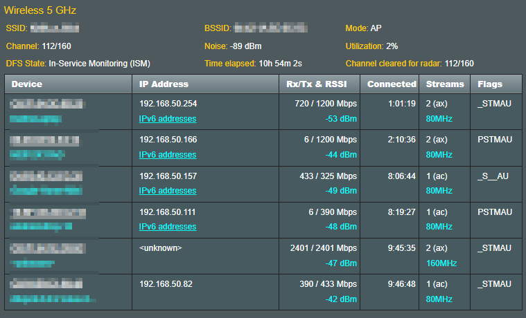

That maximum speed quoted for most routers is based on the 4x4, 3x3 or similar capability of the router.  in order to achieve it you need the same or better capability on your other network devices.  It's often not the capability of the router that's preventing high speeds, but the capability of the connected devices!
*The way WiFi 4 and beyond work, that extra capability of the router isn't totally wasted, it's used to allow multiple devices to actively access the router via WiFi in parallel!
wireless.pngMy Allegedly AX6000 (4804Mbps on 5GHz and 1148Mbps on 2.4GHz and the currently connected clients.
