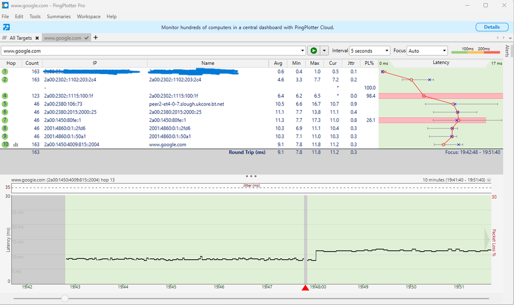

Since the latest firmware update on Mon Dec 11,19:31:49, 2023 I have noticed an increase in my resting latency after around 5-10mins after I restart the hub. Originally and for the past 13months my resting latency was 7ms but now it lies between 10-13ms with jittering and causing me unable to play games competitively.
(Image 1) I'm not showing hops 1-3 but they were completely fine as I checked, but you can see this sudden increase in latency over this 10second interval graph

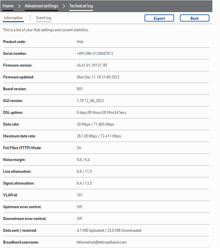

(Image 2) shows the same thing occurring the next day after I restarted the hub again in a 5 second interval.
(More noise and line attenuation details here)

My thoughts are it is the ISP server my router is bouncing off as I've seen it be slough . ukcore and redbus . ukcore I'm not sure if this switching is normal for traceroutes so that probably is normal.
Can anyone confirm or deny whether it is the ISP servers issue and how to resolve this problem and get back to a stable 7ms latency please !!

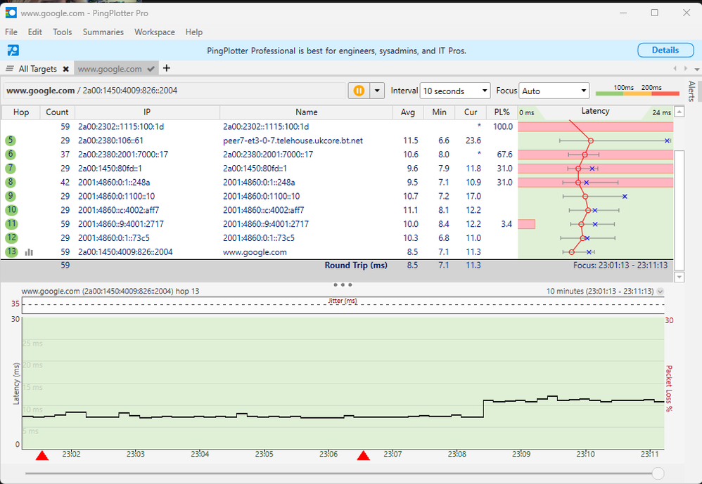

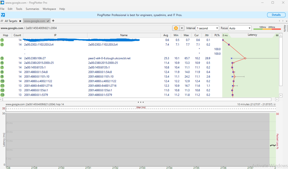

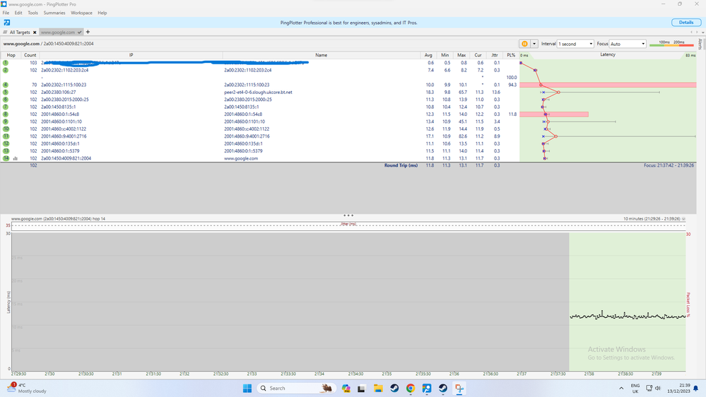

Screenshot 2023-12-13 213803.pngScreenshot 2023-12-13 213931.pngScreenshot 2023-12-13 215041.png
