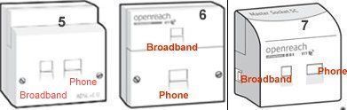

if using the master socket I presume you are on FTTC - fibre to can and copper to home.  which master socket do you have
do you have an extension socket in your room connected back to the master socket?

Hello! I have socket number seven, the openreach MK4. I do not have any other extensions, this is the only socket in the entire house.

You could get BT ( that’s assuming because you have posted on BT customer forum that you are a BT customer ) to get Openreach to relocate the master socket , but that’s not cheap ( £100 ish ) alternatively , assuming it’s a wired and not wireless connection you need , run a long Ethernet cable yourself from the current router location to your PC, or as stated a longer xdsl ran from the socket although this is more likely to impact the performance of your broadband service.

Simply get a long RJ11 - RJ11 cord  as a replacement for the existing short RJ11 - RJ11 cord connecting your master socket to the router.
