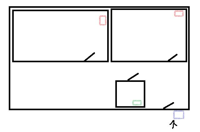

Hey!
Here is my simplified flat!
Recently Openreach installed a small fibre box above my front door (bottom right gray with arrow).
So I ordered 900 at last!
An engineer has to come out at the end of the month.  I need to ask my Landlord (and optionally ignore him)!
So  they are going to drill into the flat, and then as far as I understand, are going to drill through to the green box and replace it. That is also the electrical cupboard but there is no electrical socket in that cupboard and that is where the "Master Phone Socket" in days gone by exists.
But I have 2 other sockets in orange.  The top right is garbage and never used (yet), however  the top left is where I have my Hub connected to.  From there I use Network cable to my work PC and TV PC (top left of top box unmarked).
So I have 2 questions:
1. What happens to the orange boxes? Are they just dead?
2. If they are dead, can I ask to make top left the new main?
Thanks!

The video and information from Openreach will help explain: https://www.openreach.com/help-and-support/full-fibre-broadband-installation-checklist
You're best discussing with the engineer that comes around to do the internal installation on where you want your ONT, router and digital voice phone service to be installed (if ordered).
As long as it's within reason and not lots of internal wiring to be laid then it should be fine.
The ONT will require power along with the router so a double power socket is needed.
Your other phone sockets (including the previous master socket) and internal copper wiring will become redundant.
