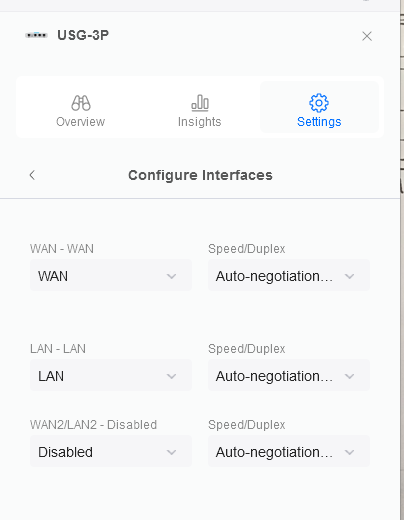

In the Unifi USG Controller Cloud Software there are very few settings I could find for the WAN port other than renaming it or changing the Ethernet media negotiated speed. ie:

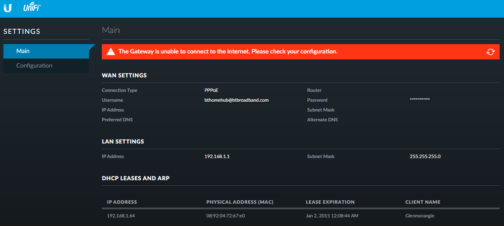

After some googling I found that there are some other settings which can only be accessed by bringing up the embedded webpage at 192.168.1.1, ie not through the management software provided. The default for the WAN was DHCP so I changed it to PPPoE which then allow the entry of user/password. So I put the BT credentials in the boxes. It also seemed to allow the entry of a DNS and Alt DNS. Not knowing what they should be I tried leaving them blank and I have tried googles 8.8.8.8 & 8.8.4.4. Neither seemed to work :
On the HG612 the DSL LED is lit, so I assume it thinks there is some sort of line connection. The WAN port of the USG is into LAN1 on the HG612 and the LED's on the port are green and flash occasionally.
However the USG is not seeing internet connectivity, as per the above screen shot.

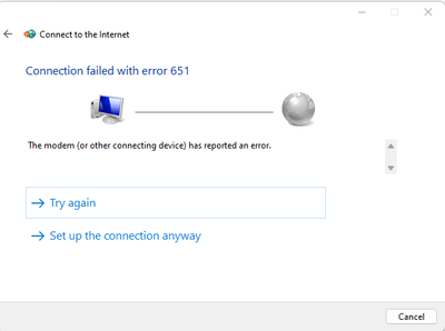

So I have now tried to add new PPPoE network connection by directly connecting between the Ethernet port on my laptop and the LAN1 port of the HG612.
I have tried with my Win 11 laptop using these instructions https://getlabsdone.com/how-to-connect-pppoe-on-windows-11/ and also with my old Win 10 laptop.
I have tried with both of the HG612's I have and with different Ethernet leads. Every combination results in the modem connection failing. I always get 'Connection failed with error 651'.
So still stuck, but now with two boxes that both do the same thing.

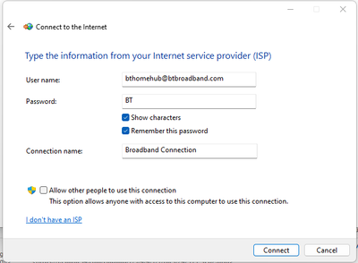

Are you sure you are using the correct PPPoE credentials?
the DSL led solid green on the HG612?
username [email protected]
password BT
Turn off Wifi on your laptop so that the Ethernet port is definitely being used for connection.

I tried again with both HG612's and the WiFi turned off :
Error 651 in both cases.
I believe the connection settings are all correct.
