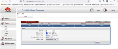

I think I have it licked...
I eventually got both my HG612's unlocked and the webgui firmware loaded as per the Kitz instructions above. What seem to do it was taking the boards out of the box so I could be sure the reset button was getting pressed.
So I got this on 192.168.1.2 (I changed the webgui IP address in the LAN settings first so it did not clash with my USG Router webgui).
With the hint about PPPoA from everybody above I found these instructions :
https://vessinity.wordpress.com/2019/05/11/configure-bt-echolife-huawai-hg612-as-adsl-modem-only-dev...
So I pretty much followed them with success. The only bit I found to be missing was to first setup the ATM here before being able to see it in the layer 2 interface drop down :

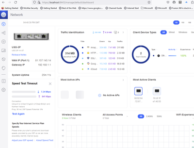

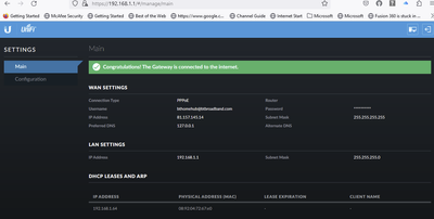

After that my USG reported internet connectivity :

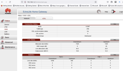

Speed testing on the USG I am getting pretty much the same result as the BT Home Hub :
