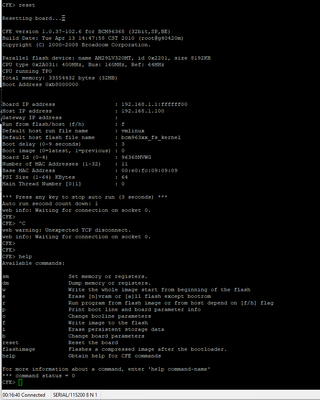

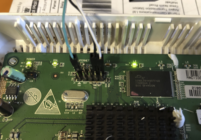

I don't seem to be able to get into the webpage to update the firmware on either of the two HG612's I have. I.e. holding down the reset button, connecting the power lead, wait 5 seconds and release the reset. This is supposed to bring up the firmware loading page at 192.168.1.1. But the its not found. I can ping 192.168.1.1 so I know the board is there.
I have opened the box and solder a header to what looks like its JTAG connector. I then connected a 3v3 TTL Serial USB convert.
With PuTTY I can now access what looks like a boot loader :
However what to do with it now I have some access ?
What does look odd is the port number for the IP address. It has :
192.168.1.1:ffffff00
I would have expected something more like 192.168.1.1:80 or just 192.168.1.1. So I wonder if this why I can't bring up the webpage because it has a whackey port number, i.e. 4294967040

Message 36 of 46
Re: How to configure HG612 modem to connect to BT Broadband ?
Go to solution
Can you Telnet into the hg612 rather than web access?
4,358 Views
Message 37 of 46
Go to solution
Connection is refused on port 23 (Telnet)
