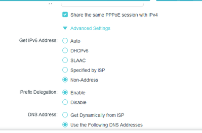

It doesn't seem to want to save with these settings.
just says operation failed 😞 I've read others have had problems due to the /56 prefix, or rather TP-Links reluctancy to support it 🙄

Try DHCPv6 or failing that Auto for Get IPv6 Address

It just gives me constant operation failed for anything under the PPPoE setting

What options do you get if you untick 'Share the same PPPoE session with IPv4'
The IPv6 settings are not related to PPPoE, its a different setting.
