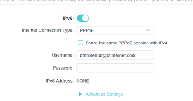

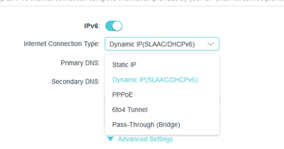

Yeah, just had a look at the online emulator. Try setting IPv6 to Dynamic IP rather than PPPoE

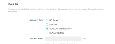

Just to confirm here, should I be using DHCPv6 on the LAN side?
or leave as is.

Leave as is , but I guess that didn't work either.

Well it says succeeded but Router doesn't have an IPv6 address, I dunno if I should whack DHCPv6 back on the LAN side so devices get their IPv6 addresses againk I was reading BT assigns them to devices directly? dunno if that's correct but made me assume to leave it on SLAAC + Stateless DHCP.

No dice changing the LAN side.

Try these settings, save and then reboot router.

As for the local allocation, BT assigning the local IPv6 addresses for all individual devices would be "pass-thru", certainly on the Asus it seems there is local DHCPv6 with addresses being stateless (as mine is set up) or stateful where they are assigned within a tight block!
