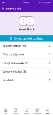

Hello, please it's quite a few now that I'm attempting to replace my smarthub2 with a decent device, but unfortunately last time i dug into the internet connection matter the fastest line was adsl2 , so now with fibre and ont modem i am very confused. I've been reading and asking a lot but now I'm even more confused. So i have the open reach small white box which connects to a bt smarthub2, the connection type here is FTTX, speed is about 75mb in download. I tried with a Netgear nighthawk 7000 which is a modem router supporting all sorts of connections, but when i put isp username and password respectively [email protected] and BT it always says credentials are wrong, so i assumed there's something wrong with my Netgear. I bought a TP-Link Archer vr2100 which is a modem router as TP-Link support suggested it would work, but same issue, when i put isp username and password this one too says credentials are wrong.
I do not want to use one as a router and one as a modem with an ethernet cable , i want to throw the smarthub2 away or leave it if no swap is possible.
Please would anyone suggest what's wrong? Did bt change password and username ?
Thanks...
