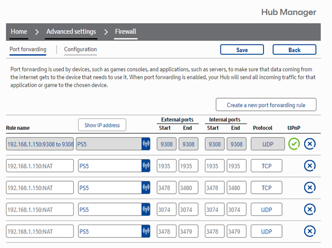

Hello BT, I have a Smart Hub 2 router and I am trying to achieve a NAT Type 1 on my PS5. I have already assigned a static ip address on my PS5 and therefore, added these ports to open:

As you are on a 192.168.x.x network you are highly unlikely to achieve a NAT type 1.
Have a read: NAT Types: Network Connection Quality (portforward.com)

Did you read the article I posted a link to?
To have NAT type 1 on a PS you effectively have to be directly connected to the Internet, not on a private address. If you are using a router, it would need to be in bridge mode with only your PS connected - not possible with a SH2 (and a bad idea generally.)
