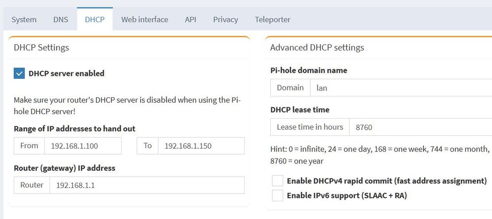

In my opinion, Pi-Hole is the best solution to that problem, it blocks most of that by default, and you can add you own domains to be blocked as well. The audit log it produces, give a good idea what is being accessed, and you can look the site up to see what it is, then add it to the blacklist if you do not like it. It filters all requests.
You disable the DHCP server on the home hub, and use Pi-Hole instead to use whichever DNS servers yo wish. I use Cloudflare  ones.

You disable DHCP on the home hub, and use the DHCP server that is part of Pi-Hole.
I have both a Home Hub 4 and a TP Link router, but I prefer the TP link one, as its not under the control of BT. Its the TP link one in use below, hence the gateway is 192.168.1.1
It also has the advantage that you can reserve IP addresses, and name clients with sensible names.

I have used a long lease time, as most devices stay connected all the time, and are reserved anyway. The main advantage is that all devices will use those settings. If you have a Smart TV, you can block the adverts, and stop it reporting what you view.
Don`t forget to set the DNS server addresses on the DNS tab. I only chose CloudFlare, as its supposed to be private.
