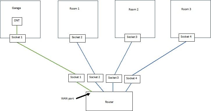

As people have said, they may be just phone cables, but if they are ethernet then you should have something like this:
