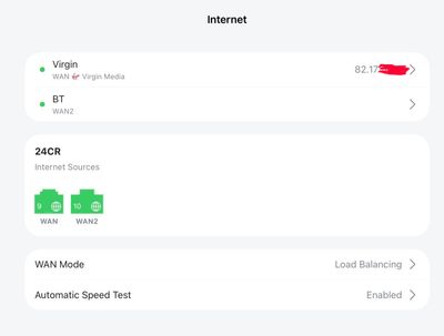

I notice you are attempting load balancing 2 wan interfaces, have you tried just configuring your router for a single wan interface to see if that is causing the problem.

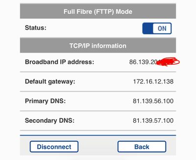

You can verify if your modem is working correctly by setting your BT Smart Hub2 to FTTP mode and connecting the modem to port 4 which will be a WAN port.

@licquorice I tried connecting the EDI VDSL modem to the WAN port on the BT hub and tried connecting (in the management interface of the BT hub) and it didn't seem to connect.
So I think it's all pointing to the EDI modem (bought off eBay) being the source of the problem...I'll soon have the Huawei which I hope I can use to solve the problem and post back here to confirm the solution for others.
Thanks everyone!

I've unplugged my other WAN (Virgin) and tried a few settings but this is what I think looks to be the correct settings but still not getting any joy...is there anything else obvious that I'm missing?
