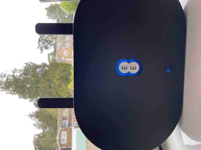

5,254 Views
Message 17 of 17
Re: Poor 4G Signal for Hybrid Connect
Go to solution
It has taken me a while to work out how to re-size a photo so it can be accepted on this site. This is the best I get and nothing works through it when the broadband is disconnected.
