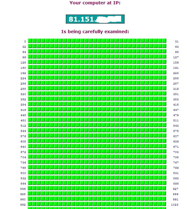

This what I would expect to see with no ports forwarded.

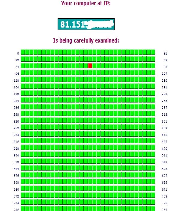

And this with a web server listening on port 80
