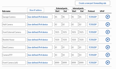

To reiterate
The bt smart hub 2 has an ip address 192.168.1.254?. This it as configured ex bt. and is on a new FFTH connection. I am more used to working with Copper and the last two Routers had the ip 192.168.1.1.
My camera`s are all set in the range 192.168.1. xxx , where xxx is the individual device ip (plus the port number range between 81 and 1025) see screenshot:-
Pete

Have you tried creating the rules using the IP address of the cameras rather than their network names?

I see all your cameras have static IP assignments which for Sky would be in the range 192.168.0.xxx. Pretty obvious question I suppose but are you sure that you saved the change to suit the new subnet addresses before you changed the router?
You could try temporarily changing the subnet on your SH2 to that of Sky and seeing if that helps, don't forget that you'll also need a pc or laptop connected to the same subnet.
