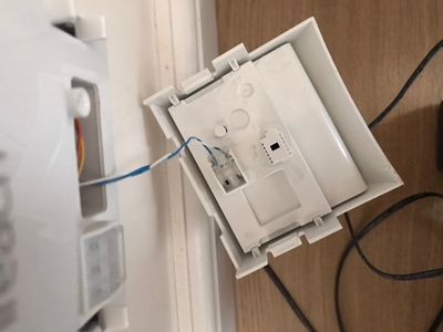

Ok thanks. I’ve opened the master socket and this is what’s inside. Do I just pull out the bit with blue wires? I feel like that might have been what the engineer told me to do. I think there was another step too though 😬.

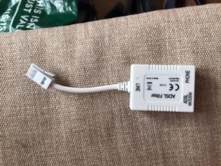

 maybe I had to do something with this???

Just disconnect the blue wires.

The extension has been wired to the data extension terminals so if you used a phone at the extension, you would have needed to plug the filter in first.

Ok thanks for your help. I’ve done that now, do I just leave them in the box?

Up to you whether you completely remove the cable or leave it,  in case you want to use it in the future.
