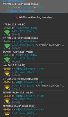

Still having problems it's almost like the wifi power has been reduced or something. Phones loose connection now round the house one end of the house is really bad. Had this hub in the same location for few years now not been a problem. Did a backup fewdays ago and a reset then restore and power cycled. Still the same so today did a full reset and re joined every device from fresh no restore.Still the same phones say connected but without internet cycle wifi on phone  and they come back online wired devices fine. Smart plugs on 2.4ghz keep disconnecting and searching. Never had these problems until the latest firmware release.🤬 also tried turning the smart channel settings off and using the ones it had auto selected. As they had no neighbours on them when i did a scan.

 Just been scanning I don't remember having these ee hotspots on my router? I had my own bt plus a network public could use with a code. Which is i think the one now called ee wifi with no security on but ee wifi-x ?

BTWifi has now been rebranded to EEWifi hence the EEWifi networks that you are seeing and as such all the BT networks that are showing will be transmitting the EEWifi networks.

Yeah guessed that just wondering why so many and is that causing all my wifi issues.
