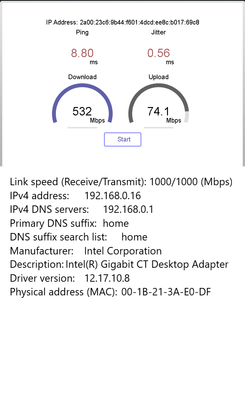

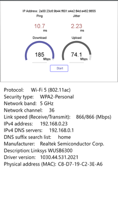

Just as a further to this, speed checked both wifi and eth, results below.
