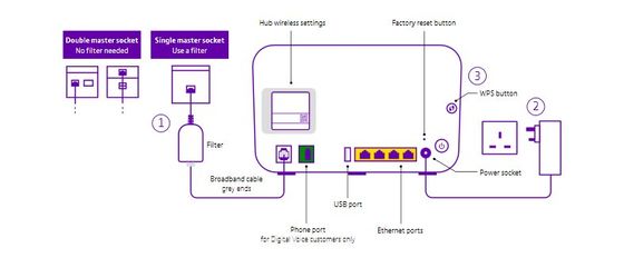

Message 8 of 13
Re: Solid Orange when ethernet cables plugged into any of the additional Ethernet ports
You should have one of these types of connection.
Connection to your Openreach phone socket.
Or
Connection to an Openreach Optical Modem.
Your Virgin router should not be connected to anything, and must be turned off.
