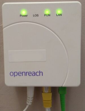

do you have an ONT like this and hub connected using ethernet cable to hub wan port

The switch will be for distribution after the router. Assuming that you've ordered a Full Fibre service from BT, there should be an Openreach ONT somewhere & the Hub's WAN port plugs into that. You then connect one of the other LAN ports to the switch.

As imjolly says, it sounds as though fibre has been run to the house but you are waiting on Openreach putting the ONT in.  (ONT = Optical Network Termination.  The picture shown by imjolly.  Effectively the “master socket” for a full fibre connection).  BT should contact Openreach to put it in when you order "Full Fibre".  (Just "Fibre" is FTTC and should connect through a master socket).
The arrangement is ONT ethernet port to the WAN port on your router and then an ethernet cable from one of the LAN ports on the router to the switch.  The purple cables on the switch then distribute to the individual rooms.  The router is the start of your network, (the LAN), so it has to sit between the WAN and your network.
