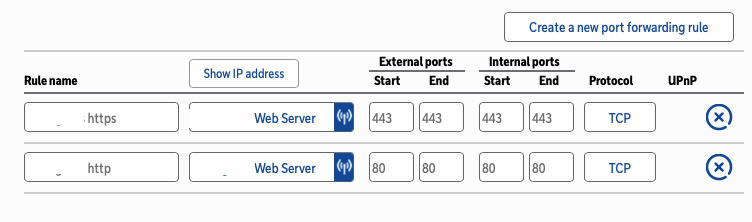

I had a brief look through these posts and I was curious because I have two Raspberry Pi devices sitting in my comms cabinet, and one of them is acting as a web server - port 80 and port 443 are set in the Smart Hub 2 Firewall, forwarding these ports onto that Pi, and I have had no problems setting this up. The fact that you say you set up forwarding rules and ended up at your SH2 and not the Pi is interesting.
Assuming (and perhaps wrongly) that you are using a domain name (hostname) to get to your Pi, then it sounds similar to a setup I did on purpose not long ago, where I wanted to access my SH2 interface from the outside world, when I was in town. So I set a Port Forward in the SH2 (port 3734) to my Pi, then had my Pi DNAT/Port Forward 'back' to the private IP Address of the SH2 (port 80), thereby arriving at the GUI. As I said, that was deliberate, but if you have done this by accident, you could be setting an additional Port Forward on your Pi and reflecting it back to your SH2.
For me, the Firewall Rules are set as below to my web server Pi:
 I wouldn't be surprised if this is of no help to your whatsoever, but thought I would add it in just in case you would find it helpful.

Cheers - no port forwarding on the Pi, it’s been setup to receive on ports 80 and 443 for years on VM, so just had a new network to connect to, and I replicated the VM rules onto the SH2.
Very weird -  I’ve not really messed with my Pi in seven years, it just sits there happily hosting a little site. May need to do some Pi network digging.
