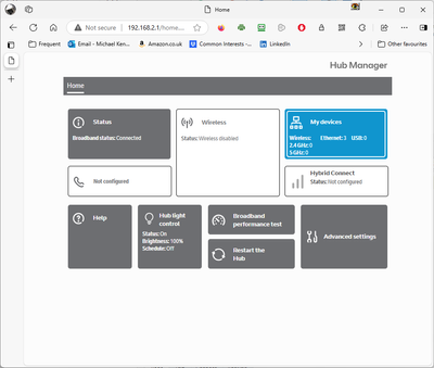

I set my Smart Hub2 to use 192.168.2.1 as its local IP address.
Advanced settings >> My Network

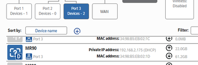

Then in the SH I went to:
  • My Devices
Look in the list for your Netgear router's local IP address – in my case, it was on 192.168.2.175.

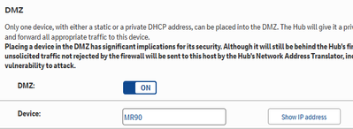

  • Firewall
  • Configuration
  • DMZ On
Look at the drop down and pick the IP address that the Smart Hub2 has allocated to your main router.
Use that as the DMZ address.
